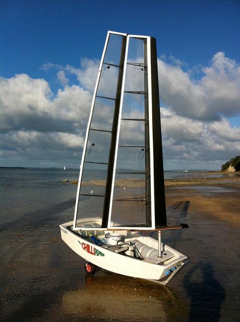

Des ailes rigides pour tous !
Bientôt ce sera partout, sur tous les voiliers :P

C'est le néozélandais Mike Drummond, directeur technique chez Oracle, qui a dirigé le projet.
Un peu d'info glané sur le site web d'Oracle Racing :
"The idea came about when talking with some 470 sailors at Wakatere Boating Club, who are always building things for boats or skateboards or surfboards," said Mike Drummond, a designer with ORACLE Racing. "The top section of our A-class catamaran wing is removable, and about the same size as an Opti rig. It was very easy to add a standard Opti mast tube to be able to step it into a normal Opti."
When it was trialed ahead of the Nationals Drummond was impressed the sailors asked very good questions about how the wing works and why it has a slot. The wing isn't class legal so it won't be seen on the racecourse in the immediate future, but down the road wingsail technology will undoubtedly become widespread.
The wing was constructed with the aid of James Turner and Logan Dunning-Beck, the 470 sailors from the Wakatere Boating Club.
“James made up the plywood control arms, Logan rigged it up; then it was stepped and sailed within a couple of days,” Drummond said. “The rig is a little far forward so the helm is a bit light, but it sails easily. It hasn’t lined up against a conventional rig though – as you can see it is a bit smaller in area.”
"L'idée est venue après avoir parlé avec quelques marins de 470, du Wakatere Boating Club, qui sont toujours à construire des choses pour les bateaux ou planches à roulettes ou planches de surf", a déclaré Mike Drummond, concepteur d' ORACLE Racing. "La partie supérieure de notre aile d'un catamaran de classe A est amovible, et fait environ la même taille qu'une plate-forme Opti. C'était très facile d'ajouter un tube de mât Opti standard pour être en mesure de l'adapter à un Opti normal."
Quand il a été mis à l'essai au National, Drummond a impressionné les marins qui ont posé de très bonnes questions sur la façon dont l'aile fonctionne et pourquoi elle a une fente. L'aile est hors classe-Optimist de sorte qu'elle ne sera pas visible en régate, dans un avenir immédiat, mais cette technologie de voilure devrait sans aucun doute se généraliser.
L'aile a été construite avec l'aide de James Turner et Logan Dunning-Beck, régatiers en 470, du Boating Club Wakatere.
"James a constitué les bras de commande avec du contreplaqué, Logan l'a gréé, puis elle a été testée pendant quelques jours", a déclaré Drummond. "La plate-forme est un peu loin sur l'avant de sorte que la barre est un peu légère, mais elle navigue facilement. Elle n'a pas été alignée contre un gréement classique mais - comme vous pouvez le voir- elle est un peu plus petite en surface ".
